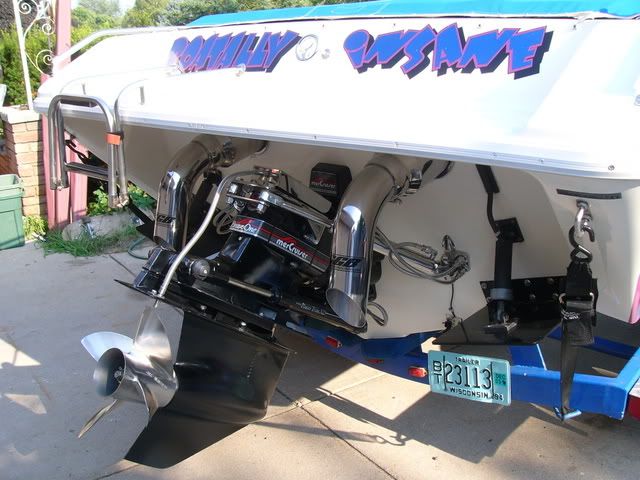

I have a friend looking for information about add-on exhaust tips that direct the exaust down into the water from his thru hulls. I have seen them before, and have heard them called Donkey Dicks, but can't find any information on them. He's looking for a quick way to quiet the boat at idle, but leave her open at speed. Anyone have any pictures?

GGB made me a set for my boat that clamp on the end of my mufflers. :) ....

I have "flappers" on mine just to be safe....
......But the GGB's flappers bolt inside the muffler.. :) ..

Do those put the tail pipes under water at idle? Boy that would be nice if they did.

Yes they do....
Before the "turndowns" I was 94 db at idle and couldn't hear sh!t while underway....
With them I am 84 db at idle and now I can hear my passengers saying slow the [email protected] down!!! :) :) :winker:
