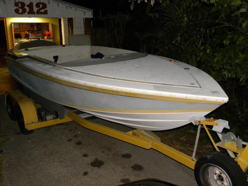

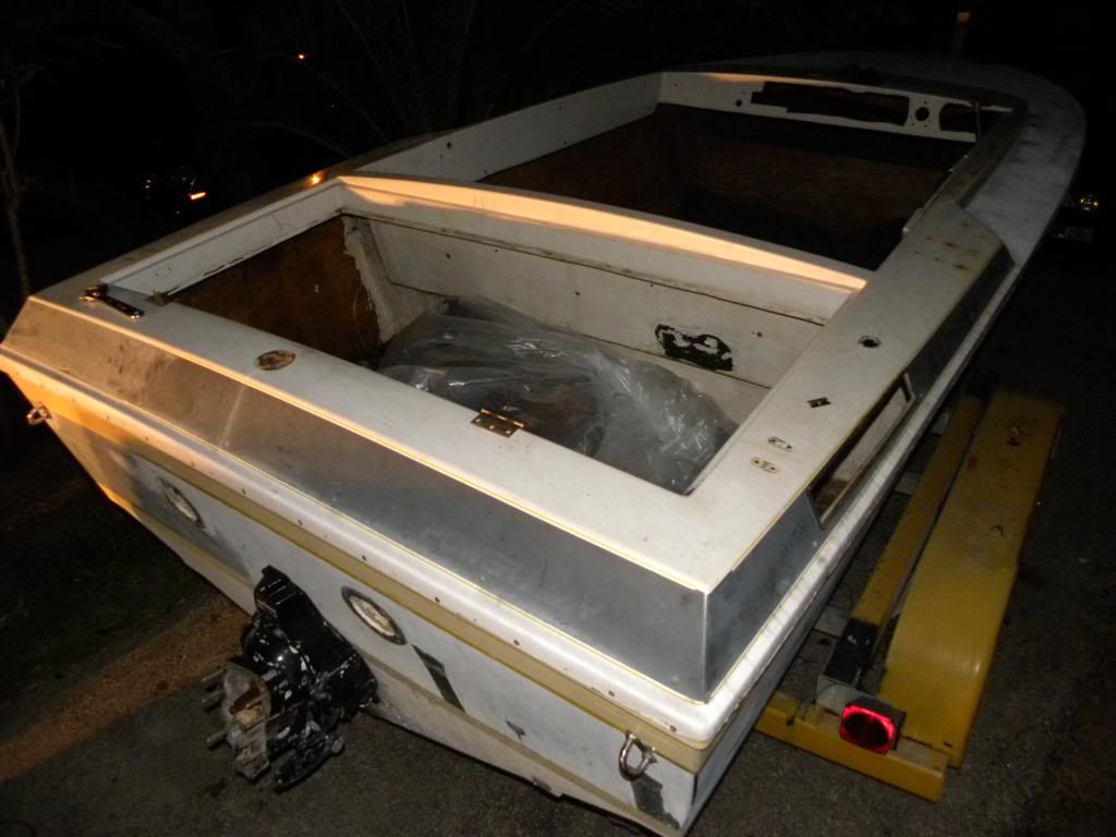

Started up my long a waited project. Plan is "do work"
Picks for kicks...

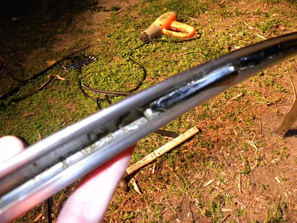

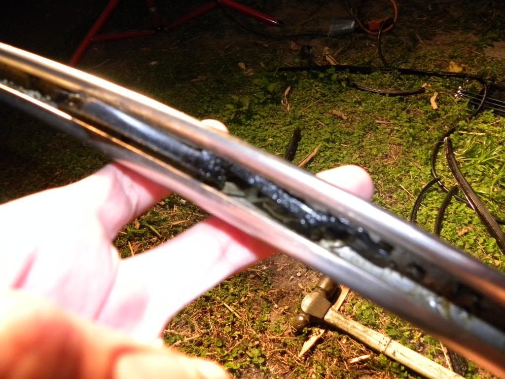

Someone glued the crap out of the top windshield trim, noticed it when my windscreen cracked, needed to be replaced anyway...

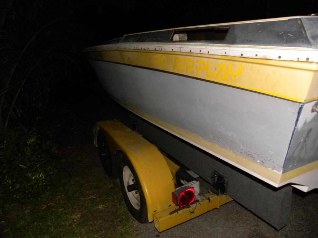

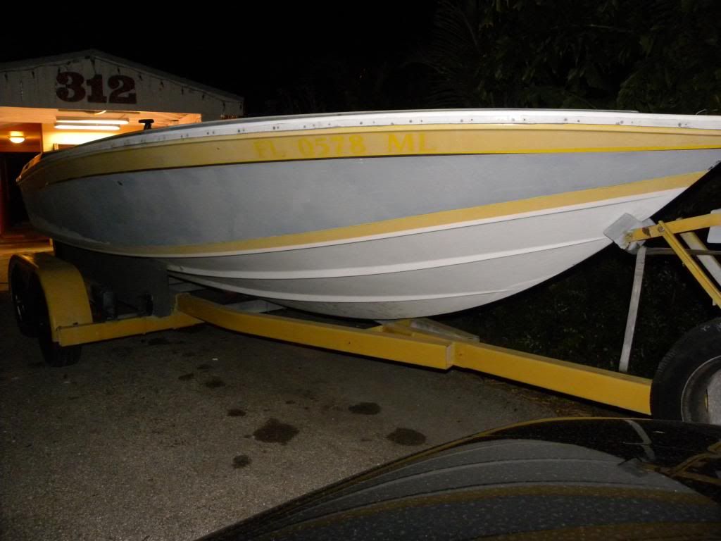

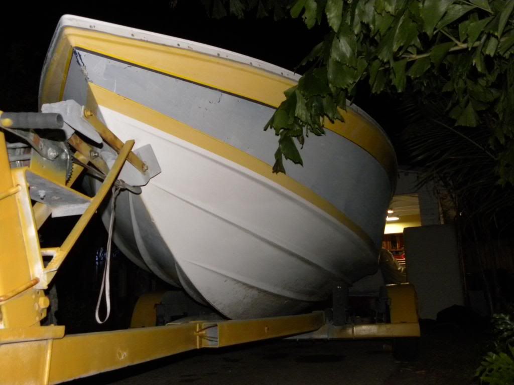

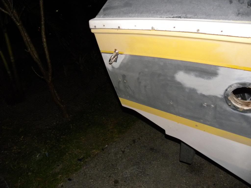

Scraped the topside paint off the sides
Threw some 120 on the DA , results were good
