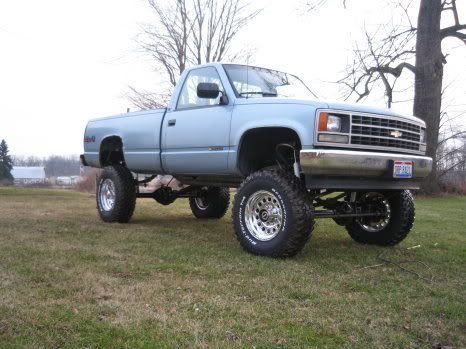

Every time I have ever lifted a truck I usually ended up regretting it and it ends up costing waaaay more money than I originally intended, but that's just me. I especially wouldn't do it if it is your daily driver. I have to admit tho the last truck I did, did turn out pretty sweet, actually its too tall and I need to lower it down about 4 inches and it will be good. BUT it's also not my daily driver, in fact the only time it gets driven is during deer season and if it snows bad in the winter....
#3 ·
And since this took me a year and cost twice as much as I planned :D . I actually bought the truck for the sole purpose of doing an SFA on it, designed and built all the brackets myself and it actually drives better/straighter than it did with the IFS at 70 down the highway(granted the IFS was 20 years old but still).
